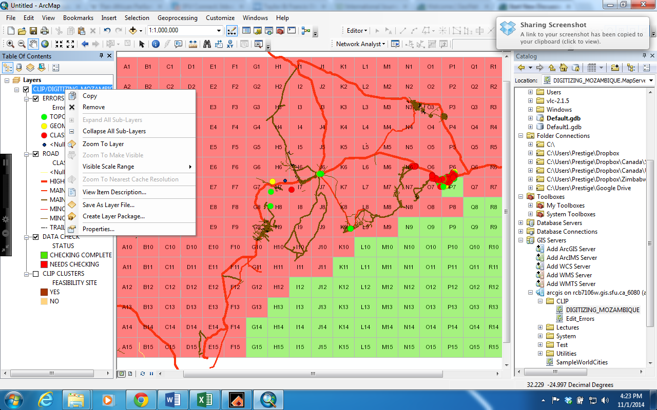

I am trying to edit a feature service in arcmap. I have seen a number of tutorials online about adding the service into arcmap, right clicking the service and selecting edit. This will supposedly store a local copy of the service and sync with the server once edits are done? My problem is when I right click my service I do not get the option to edit it (screenshot below). Is there something else I need to do. I have verified in the "services properties" that feature access is indeed enabled.
I can edit this service in the flex viewer, but no luck in ArcMAP.
Thanks for your help!

Hi Makanga,
Connect to your ArcGIS Server in ArcGIS Desktop using anonymous user or if the feature access services is secured, connect to ArcGIS Server using user account instead of publisher or administrator. if you connect to arcgis server using administrator or publisher you only can see map services. please find attached document for details

You are definitely looking in the right place. The issue is very likely with the service. In terms of feature access, make sure you allow for add/update/delete.

Thanks for your response Tobias. I do have the create/delete/update/Query options selected. Like I said in the post, I can edit my service via the flex viewer. Still puzzled as to why the edit option is not available.

I don't have time to test right now, but maybe create an ArcGIS Server connection as "user" instead of publisher. Also try making your service public and test if that works (if it does then you at least know where to look further).

Thank you very much. I had been connecting to to administer the services and have connected as a user. I can now do the edits.
