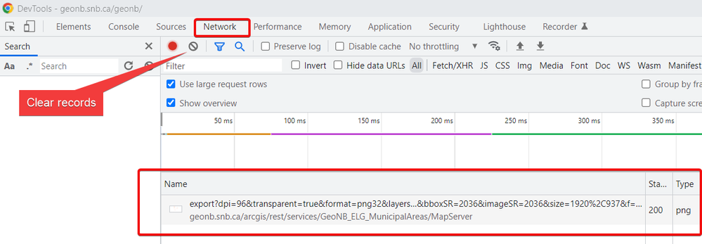

        If a layer is truned off in the web app then a map refresh will not trigger a request for that layer.  It is easy to test this.  Open the web app in Chrome and trun off all layers but one.  Now open the Chrome DevTools (press <F12>).  Choose the "Network" tab in DevTools.  Now pan the map a small amount and you should see just one request for a map service.  Turn on another map service and pan the map again - you should see two requests.  It helps to clear the records in DevTools between each pan of the map:
ChromeConsole.pngI hope this helps.  DevTools is very useful for inspecting the requests that are sent to your servers.  You should check out some of the DevTools tutorials.
