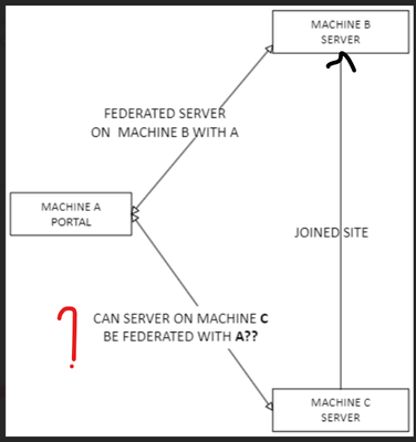

We have an ArcGIS Enterprise Multi Machine Deployment involving 2 machines for ArcGIS Server (Machine C joined to Machine B in the screenshot below). We have successfully federated the Server Site on Machine B.
Now, Does a joined machine to a server site also be federated to a Portal? If we try it returns an error stating Federateserverstatus0.
Thank you!!

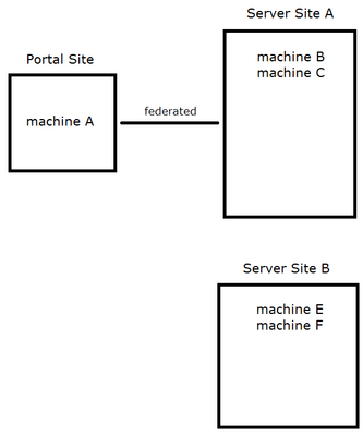

If you've joined machine C to the existing federated server site, you don't need to perform the federation workflow again.
Think of it more as though you're federating a server site rather than just an individual server. Any new machines you join to the existing site will simply be added to the federated site. If you navigate to the security section in either server manager or server admin for machine C, you should find these security pages tell you this server is federated and has adopted the Portal's security model.
If you have another server site that is unfederated and you add additional machines to that site, then all machines in this site will be unfederated.
