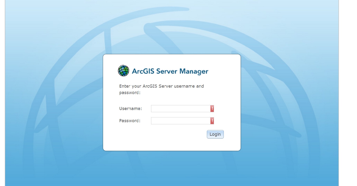

I am wondering if I could disable the external access to the link for the ArcGIS Server Manager.
For example, assuming the link is "http://gisserver.domain.com:6080/arcgis/manager/". Could I know if there is a way to disable/block the external users to access to the link?

Installing the web adaptor will allow you to disable admin access. Or conversely you could configure ARR on IIS to make it work as a reverse proxy and set your directives to not point to the manager context, but if you're going that route anyway it's considerably easier to just install the web adaptor.

Typically, the architecture looks like this:
database---GIS Server  || firewall || ---web server (IIS) ---public WWW
The web adaptor connects to the GIS Server via port 6080 (http) or 6443 (https). In order for the communication success, ports 6080/6443 are opened on the firewall.
In your case, it appears that the GIS Server is installed on the web server with your IIS instance. Is that correct? If so, you can use the Windows firewall to firewall off ports 6080 and 6443 from external traffic (or only allow traffic from the web adaptor to come through those ports)
Since you're using Windows Auth, you should strongly consider configuring your web adaptor to communicate with your GIS Server on port 6443, obtain a certificate from a Certificate Authority, and enable HTTPS/SSL at the web tier.
Otherwise the credentials supplied to access your GIS Server site can easily be sniffed on the wire.
