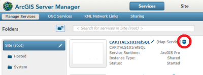

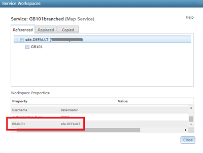

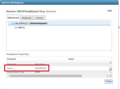

In ArcGIS Server Manager, Service Workspaces, you will see Property "Version" for Traditional versioning, and Property "Branch" for Branch versioning.
GregCarlino2
Workspace Property: 'Version' = Traditional Version Type isn't very intuitive...  but it works.  Thank you for the explanation, Chris!

The original question was about the Versioning type of map services that are already published. You are looking at the Properties of a Registered Data Store, which may or may not have been the one you used to read the data in before publishing. So I don't think those Properties will tell you about a particular service.
Stick with looking at the Service Workspaces of the service itself. You are looking for a Property called either "Version" or "Branch", note the actual value of that Property is not relevant.
