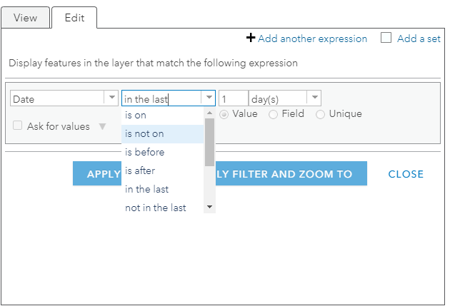

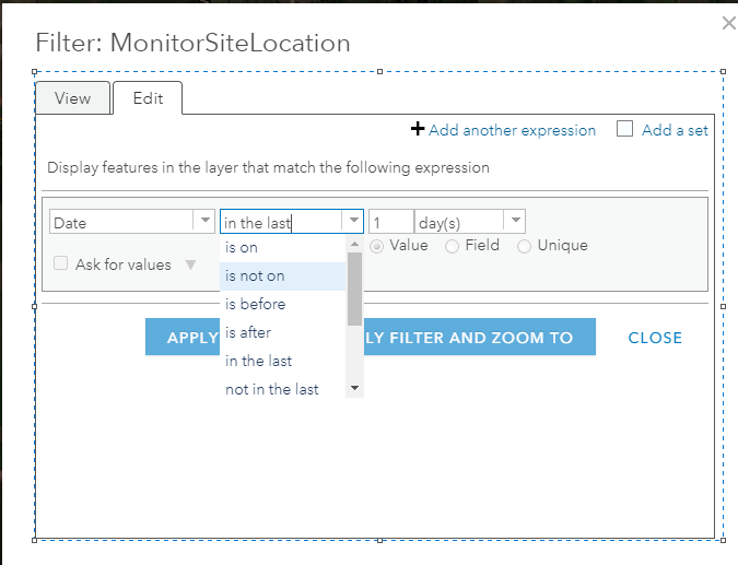

We're using ArcGIS Enterprise 10.8 and a Azure SQL Managed Instance. The "in the last" operator is not available. What can be done to enable this operator for our Feature Services?
This "in the last" operator is available, however, in an ArcGIS Online Hosted Feature Service.
Thank you in advance,
Andrew
