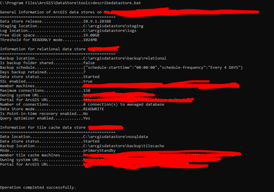

My describedatastore output is:

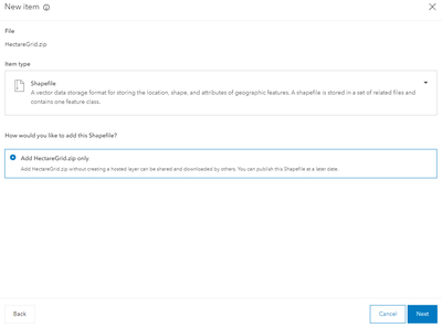

Also, when I did add a zipped shapefile, it did not come up with an option to host it as a hosted feature layer/service:

The describedatastore result looks good for both the Relational and TileCache DSs.

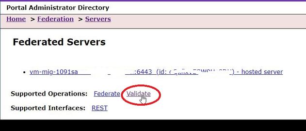

  • Check if the federation validates by navigating to "Portal Administrator Directory"  > Federation > Servers > Select "machinename.domain.com:6443 (id: xxxxxxxxx) -hosted server" > "Validate " under Supported Operations
The interface will look as the following:
Clicking the Validate link will provide you with crucial information on the validity of the Federation.
