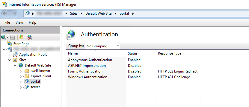

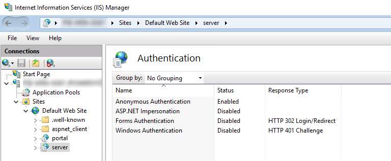

I am trying to register a new database from a federated server (the SQL Server machine) in ArcGIS Server Manager without luck.  At the same time, I am not able to validate my existing data stores like the ArcGIS Data Store.  I feel like these issues are related but I don't know where to start troubleshooting.  SQL Server permissions?  IIS?
I've tried both the web environment and the Data Store Manager in Pro.  No luck.
In the browser, I am connecting to Server Manager on the AGS machine on local port 6443. ("myserver".local:6443/arcgis/manager/site.html)
Internet Explorer is not my default browser.
IIS Authentication on the AGS machine:
Thanks in advance!

Additionally, I also wanted to mention that as per the screenshot shared. For Portal Web Adaptor you have Enabled both "Windows Authentication" and "Anonymous Authentication", that is not the correct configuration. As per my understanding it should be either of that.
If you are using AD/"Windows Authentication" with ArcGIS Enterprise Portal, then "Anonymous Authentication" should be disabled and if you are using Portal Tier then "Windows Authentication" should be disabled.
I think having both of them enabled is a correct configuration to have.
