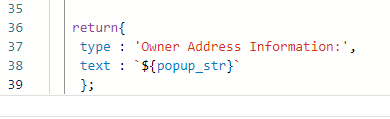

But I don't know that it makes a ton of difference. One other thing I notice is that your return statement isn't formatted the way the arcade popup element expects. Try replacing your return statement with this:
return {
  type : 'text',
  text : `${popupString}`
Happy mapping,
- Zach

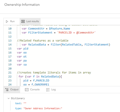

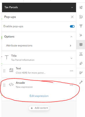

Are you trying this in an Arcade expression, or are you using an Arcade popup element?
Try using the popup element if you aren't, and place the variable popupString in the return statement. I adapted your syntax for a similar setup I have, and I was able to make it work by changing out some fields:

@ZachBodenner This is what I am using for the Pop-ups Arcade Expressions
var portal = Portal("https://gcarcgis.co.grant.wi.gov/")
var RelatedTable =
// Fetches OWNER TAX TABLE from a public portal item
FeatureSetByPortalItem(
  portal,
  // portal item id
  "d65d041ad4ed48f290a4669c4607206f",
  11, // layer id
  ['PARCELID','OWNERNME1', 'OWNERNME2', 'PSTLADRESS', 'SITEADRESS', 'SCHOOLDIST', 'SCHOOLDISTNO', 'CNTASSDVALUE', 'LNDVALUE', 'IMPVALUE', 'ESTFMKVALUE', 'NETPRPTA', 'GRSPRPTA', 'PROPCLASS', 'AUXCLASS', 'ASSDACRES', 'DEEDACRES', 'WEBPIN' ], // fields to include
  false // include or exclude geometry
var CommonAttr = $feature.Name
var FilterStatement = 'PARCELID = @CommonAttr'
var relatedData = Filter(RelatedTable, filterStatement)
var popupString = ''
for(var f in relatedData){
popupString += Text(f.PARCELID) + TextFormatting.NewLine +
"First Owner Name: " + DefaultValue(f.OWNERNME1,'No Info') + TextFormatting.NewLine +
"Second Owner Name: " + DefaultValue(f.OWNERNME2,'N/A') + TextFormatting.NewLine +
"Postal Address: " + DefaultValue(f.PSTLADRESS, 'No Info') + TextFormatting.NewLine +
"Property Address: " + DefaultValue(f.SITEADRESS, 'None') + TextFormatting.NewLine +
 "School District and ID: " + DefaultValue(f.SCHOOLDIST, 'N/A') + ' ' + DefaultValue(f.SCHOOLDIST, 'N/A') + TextFormatting.NewLine +
"Assessment Information " + TextFormatting.NewLine +
"Total Assessed Value: $" + DefaultValue(f.CNTASSDVALUE,'No Info') + TextFormatting.NewLine +
"Land Value: $" + DefaultValue(f.LNDVALUE,'No Info') + TextFormatting.NewLine +
"Improvement Value: $" + DefaultValue(f.IMPVALUE,'No Info') + TextFormatting.NewLine +
"Estimated Fair Market Value: $" + DefaultValue(f.ESTFMVALUE,'No Info') = TextFormatting.NewLine +
"Tax Information" + TextFormatting.NewLine +
"Gross Property Tax: $" + DefaultValue(f.GRSPRPRTA, 'No Info') + TextFormatting.NewLine +
"Net Property Tax: $" + DefaultValue(f.NETPRPTA, 'No Info') + TextFormatting.NewLine +
"Acreage Information: " + "Assessed Acres: " + DefaultValue(f.ASSDACRES, 'No Info') + " Deeded Acres: " + DefaultValue(f.DEEDACRES, 'No Info') + TextFormatting.Newline +
return{
DefaultValue(popupString, 'No information at this time.')}
Line 22 seems to be my problem child.

That said, I would second @ZachBodenner 's suggestion to use an Arcade popup element. You could display these attributes as a legitimate field list that way, rather than as a big block of text, making it consistent with the way a default popup looks.
You could even have a separate popup element for every section, allowing separate headers for Assessment, Tax, etc.

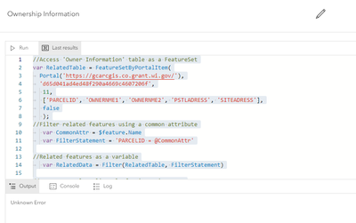

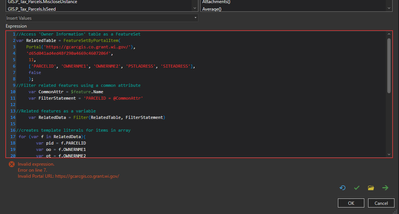

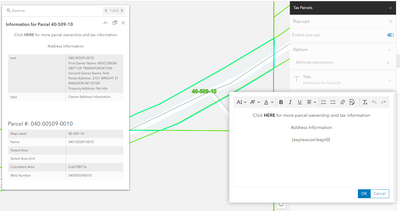

@ZachBodenner  & @jcarlson  So I think I have the template literals figured out but  I am not putting it all together the right way.  I have also taken your advice to narrow it town a bit and this is what I came up with:
//Access 'Owner Information' table as a FeatureSet
var RelatedTable = FeatureSetByPortalItem(
	Portal('https://gcarcgis.co.grant.wi.gov/'),
	'd65d041ad4ed48f290a4669c4607206f',
	 11,
	 ['PARCELID', 'OWNERNME1', 'OWNERNME2', 'PSTLADRESS', 'SITEADRESS'],
	 false
//Filter related features using a common attribute
//Related features as a variable
	 var RelatedData = Filter(RelatedTable, FilterStatement)
//creates template literals for items in array
 for (var f in RelatedData){
		var pid = f.PARCELID
		var oo = f.OWNERNME1
		var ot = f.OWNERNME2
		var pa = f.PSTLADRESS
		var sa = f.SITEADRESS
		var popup_str = `${pid}
		First Owner Name: ${DefaultValue(oo, 'No Info')}
		Second Owner Name: ${DefaultValue(ot, 'N/A')}
		Postal Address: ${DefaultValue(pa, 'No Info')}
		Property Address: ${DefaultValue(sa, 'No Info')}`}
	 return popup_str;
For whatever reason, I am still getting an Unknown Error even though nothing is flagging as incorrect:
Do you have any other suggestions?

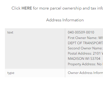

So I was watching a video about arcade and they said you can configure pop ups in ArcGIS Pro, so I pasted the expression in Pro.  I looked back and never noticed you had /portal in your URL.
Added /portal/ to my URL and it looks like it worked.
I also just came to the realization that this needed to be in Attribute Expressions. So I put it all together and this is what turned up:
The next steps are to repeat this process, however, does the "return" have to be formatted as:
This in not a suitable display format
GrantCountyGISSup_5-1716577956495.pngThank you again for all of your help thus far, I am learning a lot!
