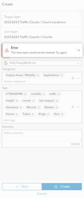

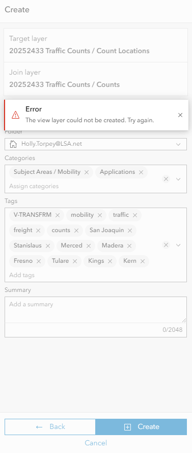

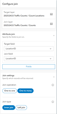

I have published a feature service that includes a spatial count locations layer and a related table with traffic counts for each location. I am trying to create a one-to-many joined view layer with the count locations as the target layer and the counts table as the join layer (see screenshot below). I've tried both inner join and left join, and both fail. Any ideas what could be wrong?

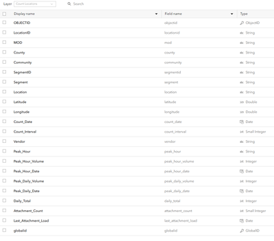

Here's the schema of the spatial count locations layer:

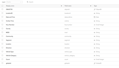

Here's the schema of the Counts table:
LocationID is the join field.
