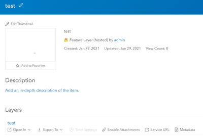

I want to list the data stored in the Data Store, ie just read the data content.
Is the hosted services content, the same as Data Store content??
Thanks
Clive
HenryLindemann
Hi @CliveSwan
So each layer in a Hosted Feature Service will be a Table in the Datastore SQL with a few exceptions; The best solution is to just manage it out of portal because editing the data in datastore can corrupt items in portal.
