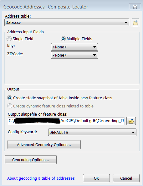

The composite locator is built upon two locators. First is the zip code locator (zip 5-digit style), followed by the land parcel locator (single field).
The data in ArcMap is a csv file containing zip codes and parcel ID. To geocode the data, I would choose either the parcel ID or zipcodes. It would then follow with a popup of 100% completed.

Is the data for the postal codes and parcel numbers in a single field in the csv or multiple fields in the csv?
Are you able to provide a screenshot of the field mapping from the map viewer when using the composite?
In ArcMap when you select the Data.csv table do you map both the 'Key' and 'ZipCode' fields to geocode the table?
