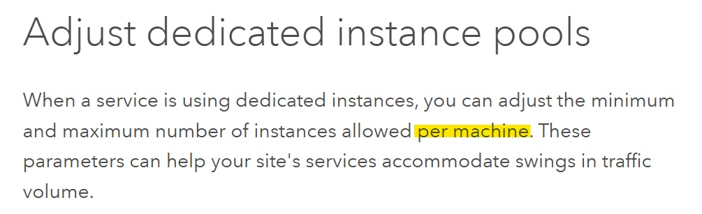

If we have set Minimum Instances set to 40, we observe 20 instances on machine A and 20 instances on machine B. So, is this a correct observation? How is ArcSOCs designed to be distributed? 20 Per machine(Total 40 for 2 machines) or 40 Per machine(Total 80 for 2 machines)?
https://enterprise.arcgis.com/en/server/11.5/deploy/windows/anticipating-and-accommodating-users.htm....

In an ArcGIS Server multi-machine site, each machine runs its own pool of ArcSOC processes for each service. The minimum number of instances and maximum number of instances you configure for a service apply per machine, not across the entire site.

With your setup of 2 ArcGIS Server nodes (machines), the total number of instances would be double what was configured in Pro when publishing. By setting 40 instances for min and max, it would end up being 80 when reviewing the service in Server Manager.
If you wanted 40 instances total, you would publish with the min and max instances set to 20.
