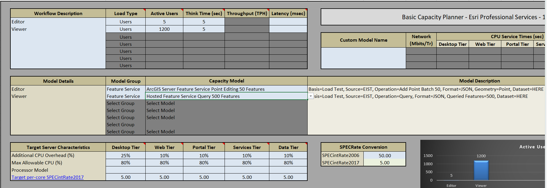

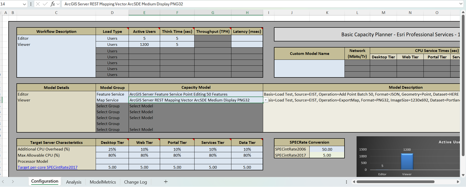

Hi guys,
I was trying to calculate the capacity needed for about 1200 concurrent hits to a service. In the simple capacity planning tools, when I entered the "map service" in the model details, it said I will need 70 cores to handle those requests.
However, when I changed the model to feature service, it said I will need only 5 cores
Is the difference between viewing data using map and feature service is really that contrast?
Regards,
Naufal
