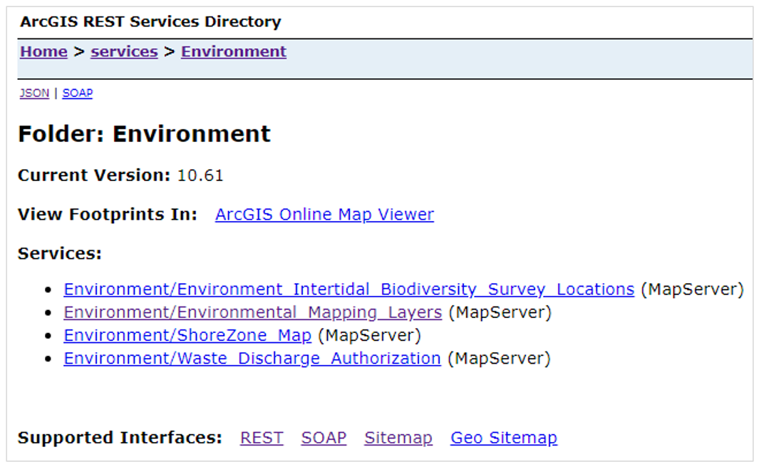

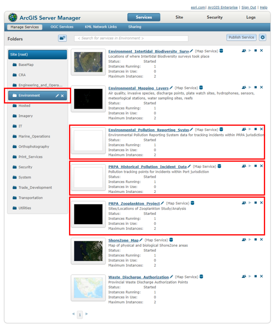

However, I'm currently unable to see any feature services in REST Services (only Map Images).  These feature services show up in ArcGIS Server Manager (services that the user can edit), but I need to get the path to the specific layer in REST Services to (apparently) bypass the bug that is preventing the user from seeing the layer when attempting to print.
Is there an ArcGIS Enterprise rule of which I'm currently unaware that doesn't allow feature services to show up in REST Services (i.e. only layers published as Map Images)?.

When viewing services from Server Manager, you will not see any feature services listed (except for in the Hosted folder if your ArcGIS Server site is set as the designated hosting server). This is because the services are map services first - with the option of enabling feature access on top of the map service.
You can easily identify the capabilities of the map service by clicking on the name of the service in Server Manager and viewing the Capabilities tab:
When you highlight the Feature Access checkbox, you can see the REST URL listed below. Clicking this link will redirect you to the REST endpoint of the feature service, which can be added to any web map or application of your choosing.
