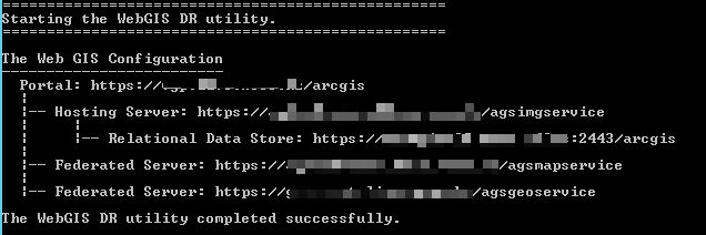

I have two environments with the following configuration (this is the production env and is working successfully):
The production environment is working fine as in the above screenshot.

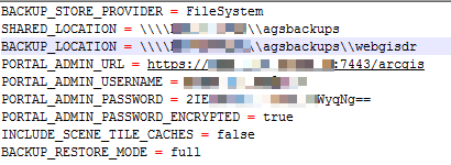

The config file is like this:
I've successfully managed to export a site/backup for each and federation validates successfully.
