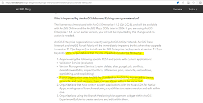

as you can see from this blog it seems like it can be done!
https://www.esri.com/arcgis-blog/products/arcgis-enterprise/administration/arcgis-advanced-editing-u...
As you can see from this blog post, it seems like it can be done: ArcGIS Blog. The blog was updated on 05/08/24 and clearly states that "The ArcGIS Advanced Editing user type extension is a license that enables advanced editing and geodatabase capabilities in ArcGIS Enterprise, ArcGIS Online, and the ArcGIS Maps SDKs." Additionally, it mentions that "The ArcGIS Advanced Editing user type extension will be included in the GIS Professional Standard and GIS Professional Advanced user types."
Given this information, it should work if you have ArcGIS Pro Standard or Advanced. I suspect this may be a bug.
Perhaps only @Esri can provide a definitive answer to this issue.
