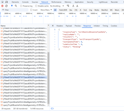

The size of the layer may have something to do with it, if you open the network tab and click the download button, you'll see something like this:
There's a few requests sent to the layer to create the CSV. If you click on the response tab, it might give you some more info on what the error is, in the above example it successfully created the CSV and returns the resultUrl property with the CSV link, but for you I'd imagine it would have status of error and maybe some other information?
RachelK
It appears to just run forever, with multiple requests. Sadly, the response tab has nothing in it, I guess because nothing's happening...
sxw_eaglegis
ok yeah it just sits on pending, I guess it times out or fails eventually. I think it would be best if you log a support ticket with Esri and they can help to try and find the cause of the issue and log a bug if necessary.
