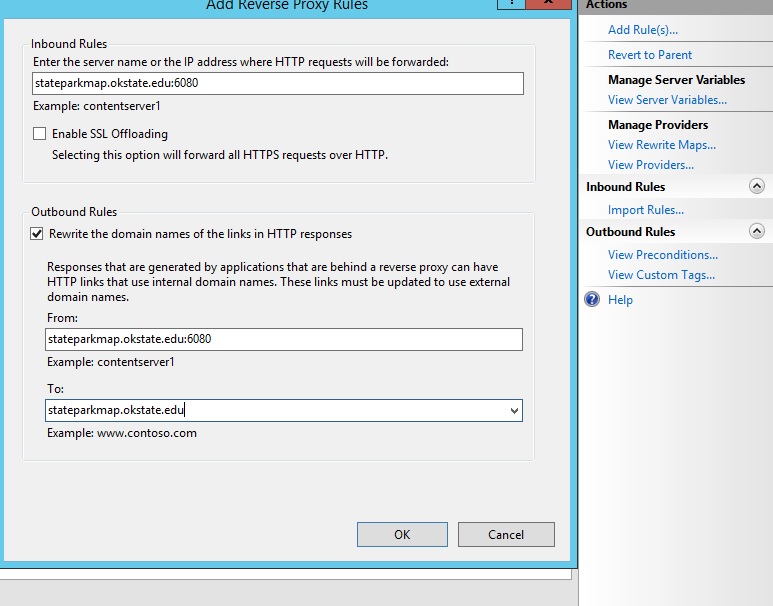

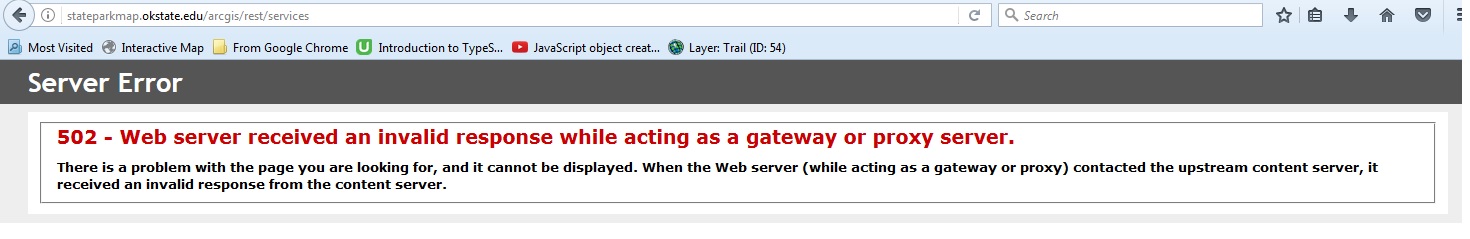

Now, the public can access the ArcGIS REST Services Directory externally (the link below). Now, my question is that I tried to access the REST Services Directory by the link below without the port "6080" like "http://stateparkmap.okstate.edu/arcgis/rest/" with the setting in the Reverse Proxy rule. However, I keep having the error message listed below.
Could you all please share valuable opinions to address this issue?

The error message

My suggestion is again, to disable public access to your internal network until you have an understanding of web servers.
More helpfully, though, don't use the reverse proxy rules within IIS.  Install the Web Adaptor on the machine that's publicly accessible to the internet and register it with ArcGIS Server.
You'll still need to disable Windows Authentication on the web server.
