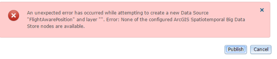

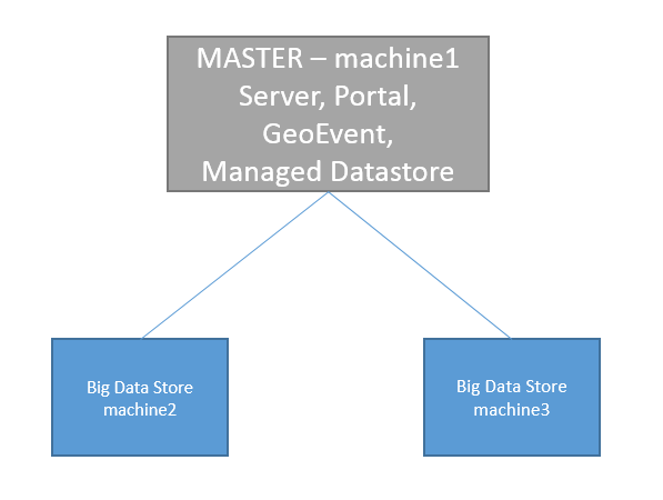

I am currently trying to configure a web GIS with a two remote Big Data Store Nodes.
On a main server I have Portal, Server, GeoEvent and Data store all running.  Everything seems to be running fine - Server is federated, the data store is managed.  SSL Cert is set up on the machine, registered with arcgis server and binding configured with IIS
When I try and connect to the Big data store from Geoevent I am informed that none of the BDS nodes are available.
