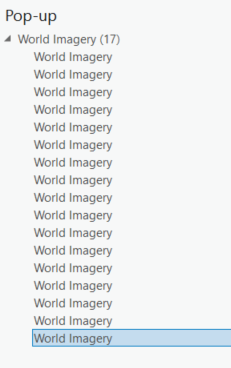

Hello,
I have a map in ArcGIS pro with the Imagery basemap.  When selecting the basemap and viewing the popup, the Imagery basemap shows 17 versions/layers yet only 1 World Imagery map showing in Contents.  Is this normal in Enterprise, and if not, how might I fix?
Thank you,
Tyler
David_McRitchie
Hello Tyler,
I believe this is the intended functionality with the pop-ups providing information about each image tile, particularly if there are more detailed image tiles laying underneath.
If you zoom in to a neighborhood level you should see that clicking results in one pop-up listing.
Hope that helps, please let me know if you have any further questions about this.
