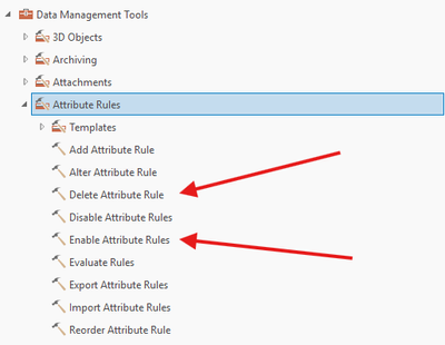

You could potentially use the ArcPy snippet from the GP Tools and create two scripts, one to disable attribute rules and one to enable with your existing scripts running in between.
