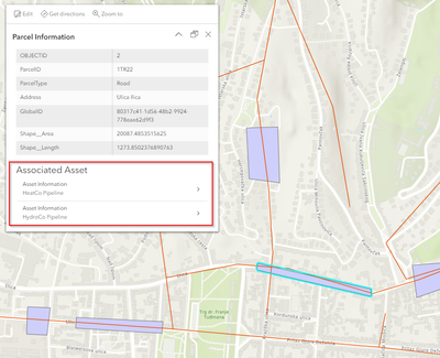

AdamT_GDi
Looks like many-to-many is supported. Not sure exactly when this was implemented but got it working with a test example below:
