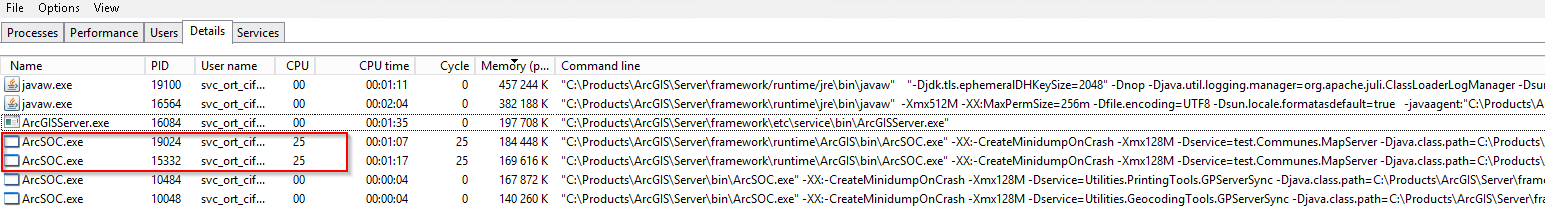

I'm facing an issue with ArcSOC wich are freezing and occupying their vCPU.

I had to install a workaround which kill the ArcSOC process when it detect a failure.

ArcSOCs do not crash but are no longer controlled by the arcgisserver process.
arcgisserver spawn a new instance but dont delete the freezing one.
