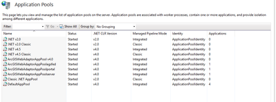

I just remembered that I forgot something, and I assume that it is also something necessary. The patch does not apply if you have multiple arcgis application pools. As you know, Esri has changed the application pool on 11.1. We were not sure which one, so we just removed both of them. Uninstalled and reinstalled web adaptor again. And applied the patch after that. This still didn't work until we removed one of the bindings , however this is also something that needs to be taken into consideration.

I'm sorry but this doesn't make sense to me: "The patch does not apply if you have multiple arcgis application pools."  Yes, at 11.1 each WA now runs in it's own application pool.  So you if you have any kind of Enterprise deploy, you are going to have at least 2 WAs - one for portal, one for the hosting server site.  We have 3 - portal, federated site, hosting site plus the original ArcIGISWebApaptorAppPool v4.0
