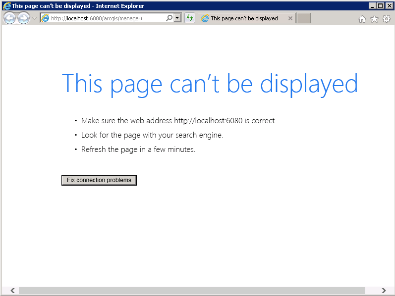

After the installed ArcGIS Server 10.1 on Windows Server 2008R2, I cannot establish the connection to this http://localhost:6080/arcgis/manager/ as shown on the image below

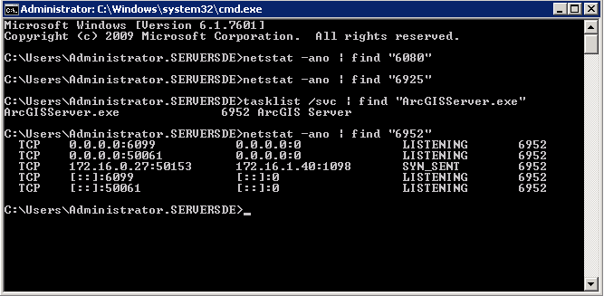

Image below show netstat for ArcGISServer.exe
3. I also tried to access the ArcGIS Server Manager page using ports listed in the image above but know luck solving it.
Could someone help me solve this problem
Thank you in advance
