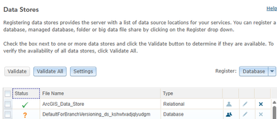

Hi all,
In the Server Manager, under Data Stores, we keep having Orange Question Marks (even after we Validate and get Green Checks, it reverts again to Orange Question Marks after a Refresh) - Anyone know why?  (We have a general Data Store area along with an SQL Vector and Raster GDB, and I need to register with the data store when publishing a new basemap from new imagery.)  Ideas?
2 Solutions
LavanyaVasudevanNES
Hey Teresa, it has always performed that way. Only shows the green check mark when you validate which is a good thing but by default it stays with the orange questionmark.
 Please let us know if you hear anything different from ESRI.
Teresa-AZ
Thanks, LavanyaVasudevanNES!  I will indeed verify with Esri since I do not remember that from several years ago and thought they stayed Green.  Cheers! - Teresa

LavanyaVasudevanNES
