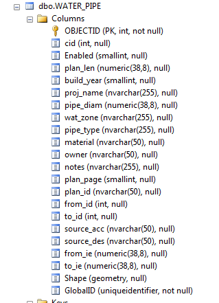

Geodatabase error: Only one spatial column is supported in this operation [gis.DBO.water_pipe][STATE_ID = 1447].
There is only one Shape column, here is a screenshot from the sql server manager:
Any suggestions on what I can do to fix this?

I'm not sure, that is a good question. I'm fairly certain they are all polylines, but is there a simple way to check for this and for empty shapes? It looks like the check/repair geometry tools only work on file geodatabases.
EDIT: All of the features appear to have a valid Shape.STLength() value (there are no nulls when I sorted the column).
EDIT2:
It looks like the issue is fairly obvious actually the rest page has two Shape fields..but how did the second one get there? The sql table has only one, and the arcmap document used to publish has only one. Perhaps the issue is with Shape.STLength(). It looks like ArcGIS Server is interpreting that field as "Shape"?
