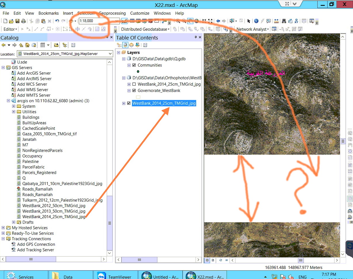

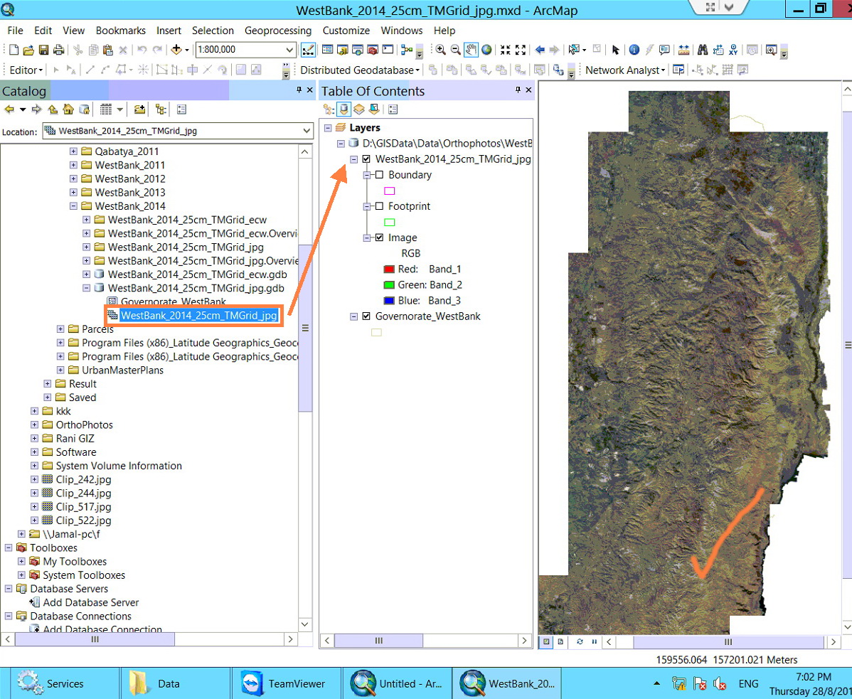

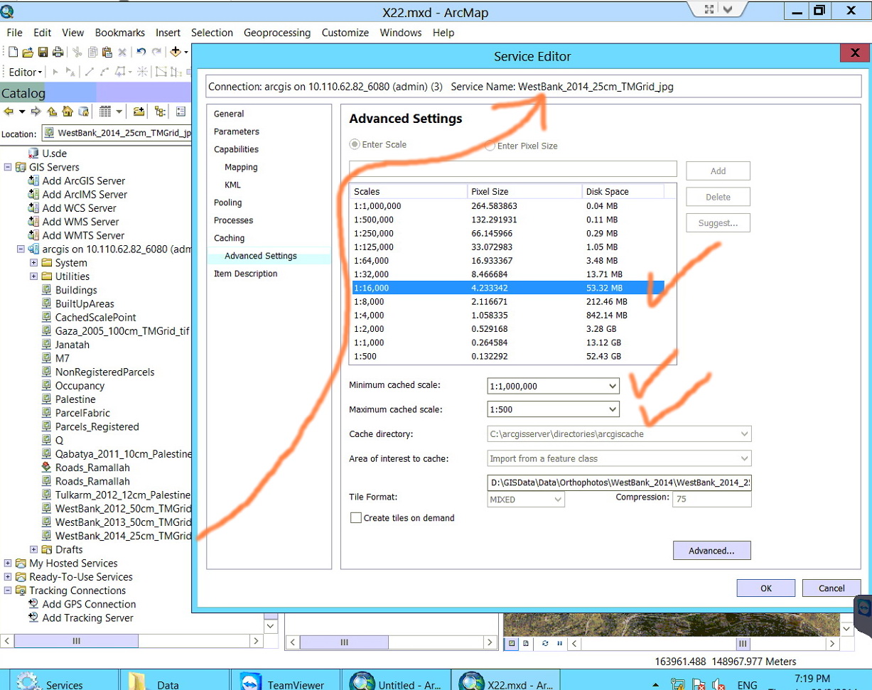

A mosaic that contain a set of images of *.jpg format is published with the caching below:

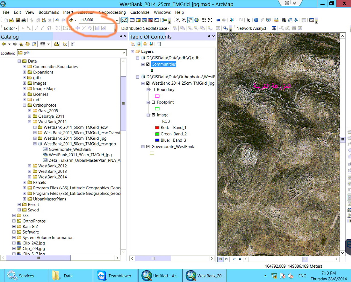

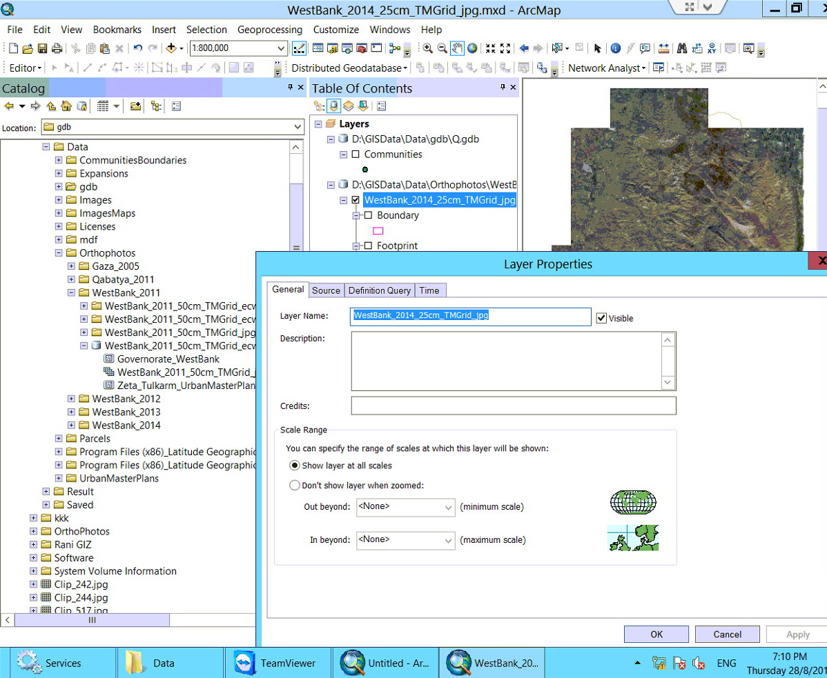

The issue here is that the cached mosaic fails to appear at particular scales and namely between 13,000 and 23,000 knowing that no scale dependency is set and the publishing is successfully completed
What might be the issue here?
Why the ArcGIS Server fails to publish the mosaic correctly as the published mosaic disappears at particular locations and particular scales?

This issue might be resolved by increasing the “maximum number of rasters per mosaic”,
