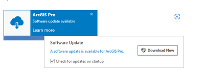

I am looking to get our ArcGIS Pro users to be able to update their application without having to sign into ArcGIS Online. Currently, when the ArcGIS Pro software notification appears, they would have to sign into ArcGIS Online to download an update through Pro. Is it possible to get this software update interface to reference a local file instead of one that requires an ArcGIS Online account? Not all of our users have accounts in ArcGIS Online since most of our data is saved in our Enterprise environment.

Thank you! That does, just confirming, there is no way to get this "Download Now" button to reference that network shared folder file, right?
I wouldn't think so, and the IT department route is probably the best for us, but just making sure.
