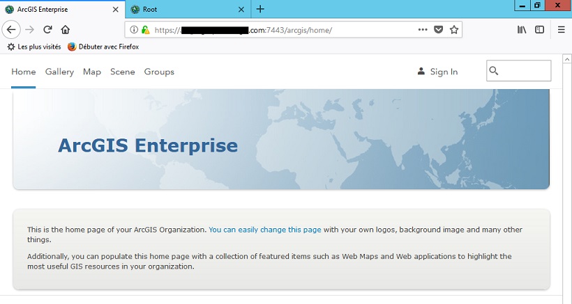

Can you try accessing https://machine.domain:7443/arcgis/home and https://machine.domain:7443/arcgis/sharing to check if your Portal is up and running?
OMARGAAFAR
Hi Kanika,
Yes both works fine. I tried with AGE Builder 10.5.1 and AGE 10.6 ;
