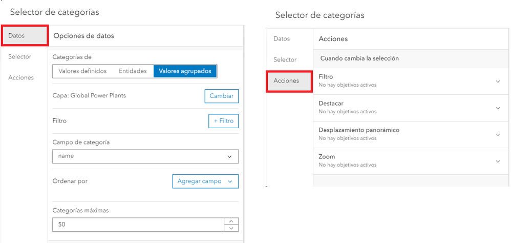

Good day,
When setting up the category selector for grouped values, it only shows the filter option under actions. This occurs when I'm working with a layer hosted in my ArcGIS Enterprise account. However, when working with a layer hosted in ArcGIS Online, all other action options appear.
What could be the reason for this?

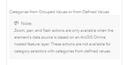

ElisabethFenn
Hosted feature layers have different actions available than layers brought in from enterprise. We've run into the same issue.
Full documentation here: https://doc.arcgis.com/en/dashboards/latest/create-and-share/configuring-actions-on-dashboard-elemen...
There's a community post about ESRI working on adding these actions for other service types too. https://community.esri.com/t5/arcgis-dashboards-ideas/allow-category-selector-to-zoom-to-selection/i...

WILSON_LOPEZ_90
Thank you for your prompt response. In the image, it can be observed that when grouping values, it does show actions such as zooming, panning, and filtering. This happens when I use a layer hosted in ArcGIS Online, but not with my layers hosted in my Enterprise account.
ElisabethFenn
