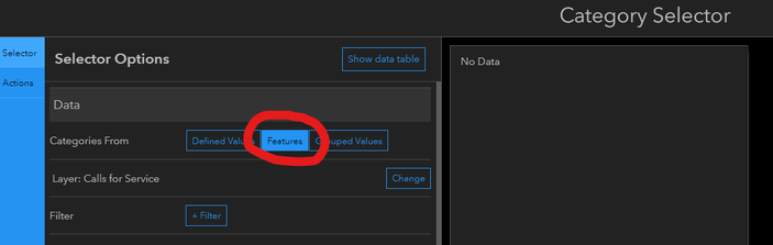

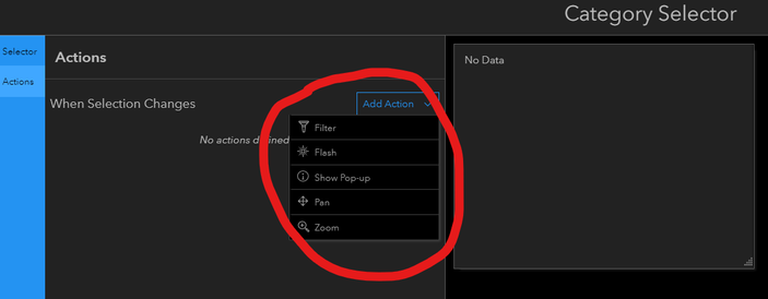

SteveOwens
If you add a Category Selector to the Header Panel and set the 'Categories From' to Features, it will give you the ability to select the actions shown in the second image below.

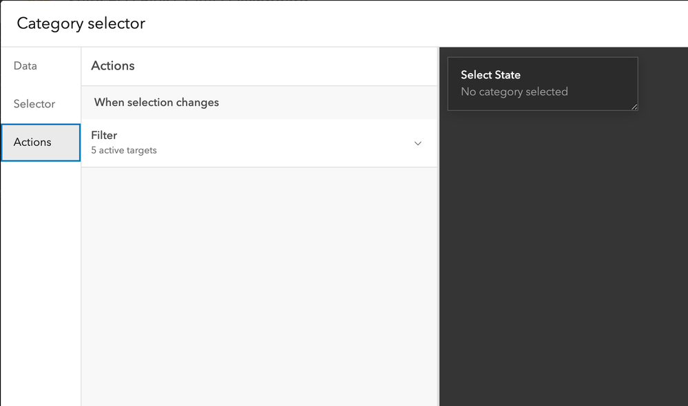

MichaelTemchine1
@SandraLuken1 I see that this is an old post, almost exactly one year now, but I have numerous dashboards with category selectors using grouped values and under actions I only see Filter. I do not see any map actions available. Am I missing something?
SandraLuken1
@MichaelTemchine1
We've added clarity into the documentation that these action options are only available with ArcGIS Online hosted feature layers at this time. We are working across teams to implement for other service types such as Enterprise referenced services.
