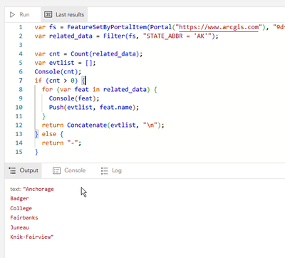

That code should work perfectly fine. It works in the Playground with some testing data.
You should look at one of the attributes in the related_data object to see if it changes (line 8 )
Console(feat.OBJECTID)
