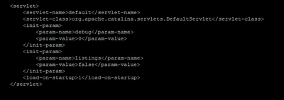

Esri Detail:
The non-default parameter “readonly” needs to be explicitly set. Not setting this value does not indicate vulnerability. Tomcat doesn’t set this option at all because there’s rarely a reason to enable write on the default servlet.
Proof:
Compare the default, out of the box Tomcat’s web.xml, which again is not vulnerable by default against the Esri implementation. You will not see a directive to setting “readonly:false” in our implementation.
Here’s a link to download the default OOTB Tomcat : https://dlcdn.apache.org/tomcat/tomcat-10/v10.1.40/bin/apache-tomcat-10.1.40.tar.gz
Here’s a complete writeup to fully substantiate our assertions:
Understanding and Checking for Tomcat CVE-2025-24813
Here’s an OPTIONS request indicating that the PUT method is not enabled (writes are NOT enabled for the default servlet (disabled by default).
