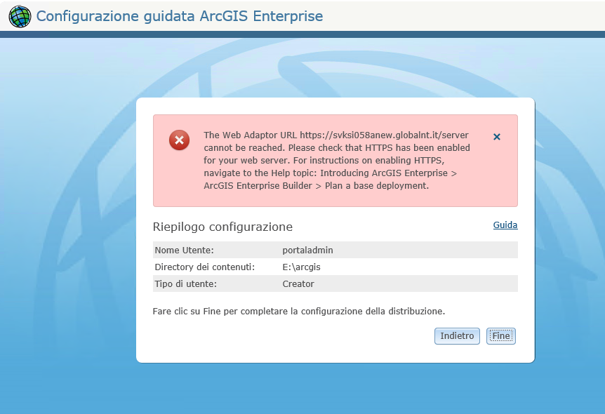

Then, opening the configuration wizard in the browser, (i changed the URL from http://localhost:6080/arcgis/enterprise to http://sit.a4mobility.it:6080/arcgis/enterprise ), after filling all the information, I reach the error:
The wizard is redirecting to the FQDN (https://svksi058anew.globalnt.it/server), and there's no way I can make it work.
I can however reach https://sit.a4mobility.it/server which redirects me to the Web Adaptor configuration page (https://sit.a4mobility.it/server/webadaptor ), meaning that probably the etc(hosts trick worked.
Unfortunately, I have no idea how I would make the Builder configuration wizard to point to this address rather than the FQDN one.

In addition, i found an interesting folder (C:\ProgramData\ArcGISBuilder10.7.1)with the AGE Builder logs, with the Web Adaptor logs for both server and portal (ServerWa.log and PortalWa.log).
They both have this inside:
   Property(S): ComputerName = SVKSI058ANEW
no trace of sit.a4mobility.it whatsoever.
Is it possible that the etc/hosts trick is not working? Has anybody else out there tried it, or am I the only one in need of a simple installation which ends up having a single machine deploy of AGE that can be reached via a public domain rather than a (in most cases) useless FQDN?
