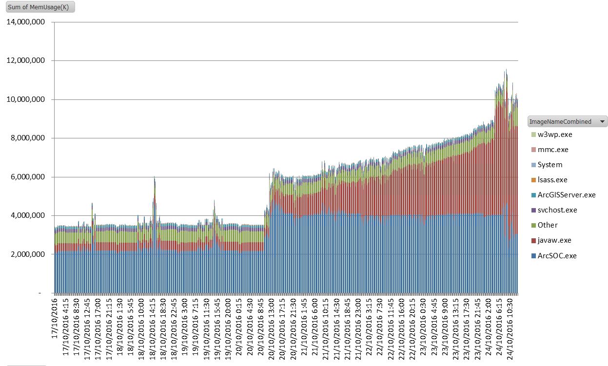

We are running 10.2.2 and I thought I would share our javaw memory issues
Chart of memory usage on ArcGIS server over 7 days
As you can see the javaw.exe memory usage expanded from late on 20/10 through to 24/10.
This server is the second in our cluster.
The only process running over the weekend was the ArcGIS Cache creation process creating 20 tiles per second.

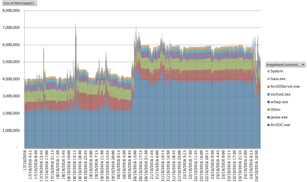

Our first ArcGIS server was running  the same process creating the same amount of tiles. It's memory profile was..
Memory usage from first server in cluster
The cache file creation process began at lunchtime Thursday with 3 cache creation processes on each server, this was increased to 8 on each server at 16:00 and decreased back to 3 on Monday 24 at 8AM.
The changing of the number of processes involves stopping the cache creation process and then starting it again. As can be seen in the first chart this stop/start had no impact on javaw memory hogging.

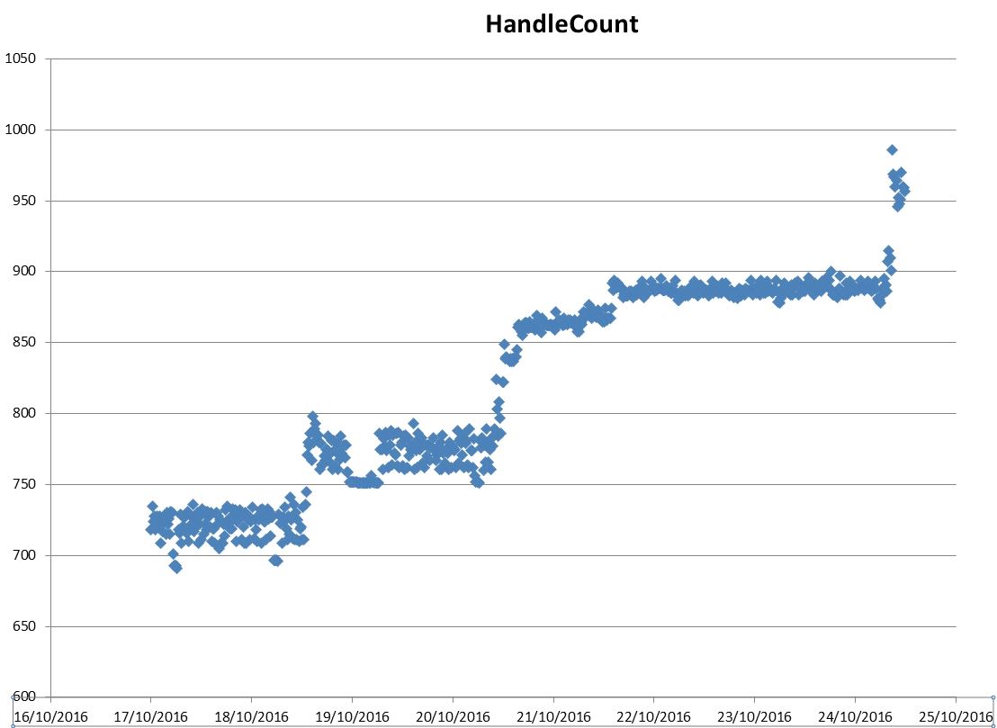

Handle count on server 2 over the period...
