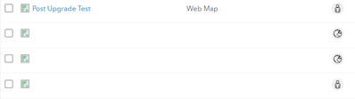

Thank you for your reply, however. Our webmaps published from ArcPro seem to be incompatible. The webmap names are missing and the webmaps  give errors when attempting to access.. It looks something like this...
I ran the UpdateArcMapServices tool and it also did not help. Did you run into anything like this during upgrade.
