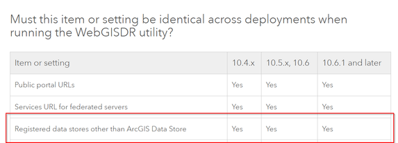

The datastore's content/data directory does not need to be in the same location for a WebGISDR restore. See the table in this document for more information - Must this item or setting be identical across deployments when running the WebGISDR utility?

Thanks for confirming, that's exactly what I would have hoped given it's more of a back end component that can be disconnected and restored to different locations. I had seen the table, but found it a little vague, given arcgis data stores are combined with registered data stores. I'm guessing it's safe to assume that the following reads No No No for all flavours of AGS DS. Thanks!

I agree that the table is vague in many areas and doesn't explicitly mention ArcGIS datastores.
The 11.4 version of the document does explicitly state that registered ArcGIS datastores must be the same in the target environment, noting that certain types aren't included in WebGISDR backups (e.g. spatiotemporal, graph)
So really, the table could be revised to add the following:
  • Registered ArcGIS datastores: yes, yes, yes
  • ArcGIS datastore data directory path: no, no, no
