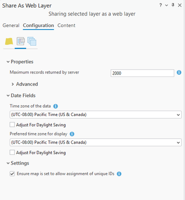

Brian_McLeer
MVP Regular Contributor
Are you publishing through ArcGIS Pro as a hosted layer? If so, would changing the settings under the Configuration Parameters help to specify the time zone?
TimLohnes1
No, just uploading a csv to a hosted layer.
