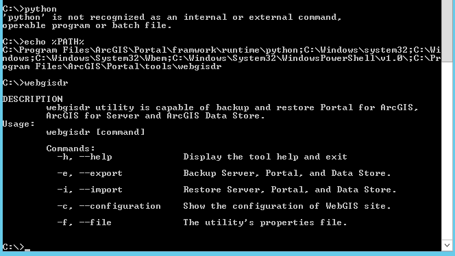

@JakeSkinner I followed the instructions and watched the video too.  I am experiencing something odd.  I updated my path, adding in the location for the runtime python folder.  In the cmd window at c:\ , when I enter python, it cannot find it.  When I enter webgisdr, it can find it.  Any suggestions?ArcGisPythonIssue 2024-03-28 151614.png

@GeorgeClark not quite sure on this, but I would simply use the full path to the python.exe when configuring the scheduled task:
