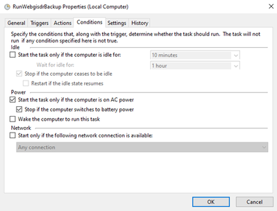

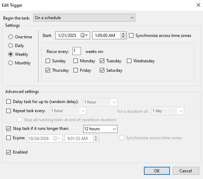

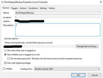

GeorgeClark
Hello,
Here are the settings in the scheduled task I have in the Task Scheduler.
Note:  In the following image, the Author and the user in "When running the task..." is a domain-level user, with Admin privileges on all of our ArcGIS servers. We use this user when building an ArcGIS server (installing all the software, etc.).
Let me know if you have questions.
