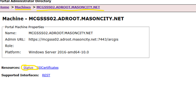

portal admin:
Check:
  • Machines → Server → Status = healthy
Can you generate a token at https://<portal>/portal/sharing/rest/generateToken

To be honest, I don’t fully understand this part: Machines → Server → Status = healthy
Could you please explain what I need to do step by step?
