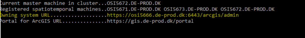

Then, why in both cases url's are different? please refer below screens
relational
and spatiotemporal
We believe since datastore is very much dependant on single machine url other than our load balance url is reason behind the isse when same machine is not working or stopped like OSI5666 or OSI5667.
We believe owning system url should be https://gis.de-prod.dk/arcgis which is load balancer url for hosting servers. ?

Saurabh Gupta‌, we found at 10.5.1 that the Owning System Url seems to be important when migrating to new hosting servers.  During our migration we found that the OwningSystem url was set to the previous host and not the loadbalanced url and it caused us problems during validation - "Error Method argument cannot be null Code 500." for the standby.  Though not entirely sure this was the only issue.  But esri support helped us correct the owningUrl by issuing registerdatastore (without unregistering)  using command line: registerdatastore.bat <https:loadbalancedURLTOFEDHOSTED/arcgis> <adminuser> <password> --stores relational.
This corrected the issue.

Just for curiosity , why owningsystemurl is different for relational and spatiotemporal as shown above??
What are these owningsytemurl's then??

Do you have any data in the spatiotemporal data store? If so, you can try to stop OSI5666 and you should see those services continue to work because the URL does not impact ArcGIS Servers ability to request data from the ArcGIS Data Store.
I'm not sure why the URLs are different. It could be related to how you registered the Data Store if you registered them separately.
