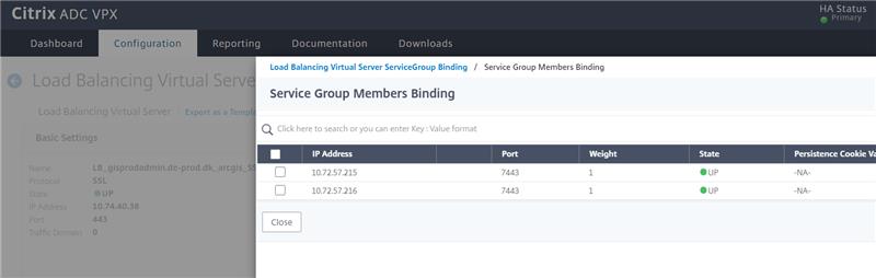

Could you please help me with this information... We have high available setup with 2 portal machines
Your Comment above
"We have setup ArcGIS Enterprise 10.7.1 with privatePortalURL as https://dnsforportal.company.com:7443/arcgis and WebContextURL as https://portaldmz.company.com/gisportal and have restarted Portal service after"
Questions??
1) What does this url in your load balancer points to https://dnsforportal.company.com:7443/arcgis
Does it point to 7443 port of high available portal machines or it points to 443 port of arcgis webadaptor of portal machines??
In our case privateportalurl points on 7443 ports as shown? Is it right or we should point it to webadaptor instead with 443 port?
2) What does this url in your load balancer points to https://portaldmz.company.com/gisportal
Does it point to 7443 port of high available portal machines or it points to 443 port of webadaptor of portal machines??
If in both cases above you're routing requests to webadaptor of highly available setup then can we use same url for both when we only have single load balancer ????
Please help we are very confused with these 2 urls
BR
Saurabh
JonathanQuinn
Esri Notable Contributor
There are a variety of different deployment scenarios for an HA portal. The WebContextURL will always be set to 443, but the privatePortalURL can be set to either 443 or 7443, or any other port, in reality. All that matters is that it can send traffic to the backend portal machines, and check the health of those machines. Our cloudformation templates set the WebContextURL and the privatePortalURL to the same URLs. On the other hand, if you configure your environment with Windows Authentication, that would be set at the web adaptor tier. In this case, the privatePortalURL can't be set to a URL that hits the web adaptors, because it can't authentication against the 401 challenge.
Deployment scenarios for a highly available ArcGIS Enterprise—Portal for ArcGIS (10.8) | Documentati...
Ultimately, your decision to use  the same URL or different URL can come down to:
1) Security - do you need to bypass the 401 challenge at the web tier
2) Network traffic - do you mind if internal traffic between Server and Portal goes through the same endpoint as client side traffic?
There is no right answer. Your requirements will dictate what your topology looks like.
