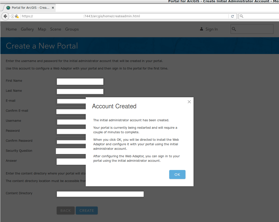

When first accessing this page, it comes up as expected and I'm offered the choice between creating a new portal or joining an existing one.  I chose to create a new site then fill in a Name, Email, and Username/Password for the initial admin user and click okay.  This spins for a bit but then loads as expected into one final page:
Account Created, last working page before eternal spin
Up to this point, everything will install normally, as expected.  But it's when I click [OK] on this "Account Created" page that the portal page will then go into an endless loading loop.

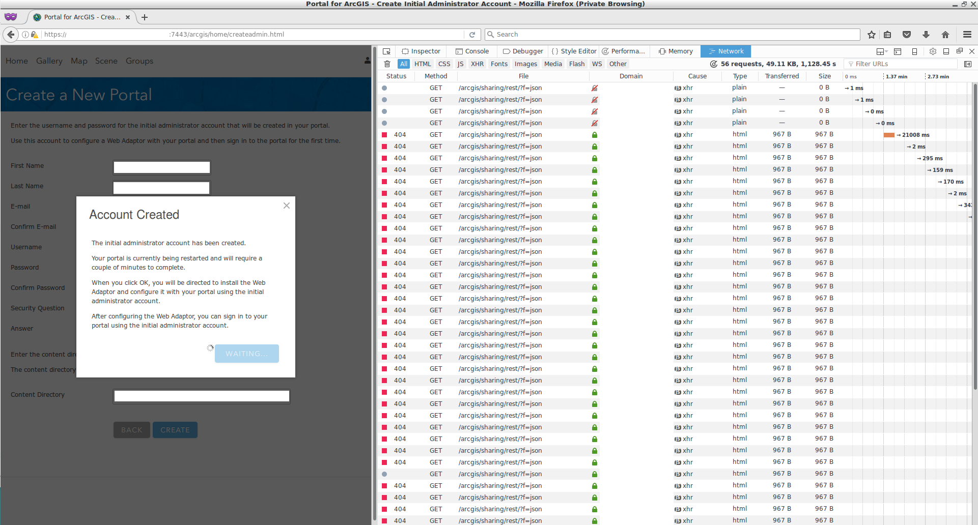

Pulling up the debug window on the side I can see a repeating call to an /arcgis/sharing endpoint that will wait, then fail with 404 before spinning up another attempt.  This process does not appear to timeout:
404 Errors
