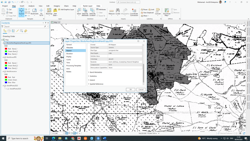

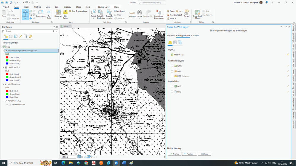

I have ArcGIS Enterprise 11.1 and I have orthophoto ECW need to publish is on ArcGIS server 11.1 . any idea or help pleas
