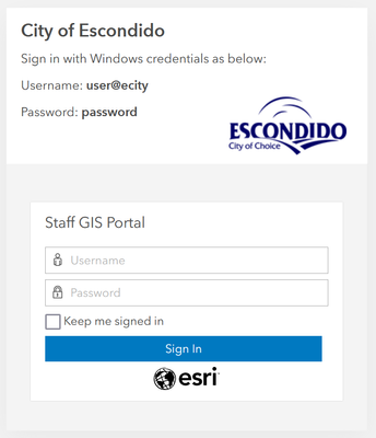

AbeCoughlin
Christina,
This is what I achieved...
To get this look, try this:
  • Find the <div> with class = "content-wrap" in oauth2.js (copy file and keep original safe).
  • Replace it with the code below (If you ignore the svg path, it's fairly simple).
  • Modify the text, id and logo for your organization.
  • Done.
Note that this does not change any functionality, just layout.
[ I'm quite sure that this is the only change I implemented at the time - if for some reason this does not work as intended, simply replace the original file and it will fix itself. I would appreciate feedback if it doesn't work and I'll explore if I made any other change and advise. ]

ChristinaCurry
Oh great! Attempt 1 did not work out (sign-in page was just blank) but it's very possible I made a mistake. I will give it another go sometime this week and let you know!
