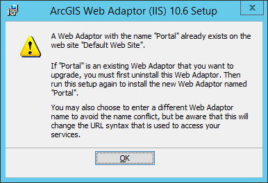

I am upgrading our Portal for ArcGIS, ArcGIS Enterprise, including both of our web adaptors.  However, I believe I made a mistake installing the web adaptor and needed to start over.  So I uninstalled the web adaptor, and then began the reinstall process, but now I'm running into an error message:
I would rather not choose a different web adaptor name in case this continues to happen LOL...so then this begs the question, if I have already uninstalled the previous web adapter then how can a web adapter with that name continue to exist on the default web site?  A second question would be, "how does one then remove the default web site?"

Perhaps the uninstall ran into problems and didn't completely clean itself up? Have you checked IIS or C:\inetpub\wwwroot for the portal web adapter application? Does this error occur during web adapter installation or configuring the web adapter to your portal?

Thanks for the response...much appreciated.  I think what I did was that I was too hasty and didn't wait for the web adaptor to prompt me to configure it after I had completed the upgrade; hence, I moved on to upgrading our GIS Server...and then its web adaptor as well.  I will explore IIS and C:\inetpub\wwwroot too though.  Other than searching for everything in the registry and deleting every single occurrence of this install this might be my last hope.  Very annoying.

If the web adaptor is uninstalled, (confirm through Programs and Features), just delete the "portal" folder from C:\inetpub\wwwroot as AZiegler-esristaff‌ mentioned. Since you're upgrading, you don't really need to unregister it from Portaladmin but it won't affect anything if you do.
