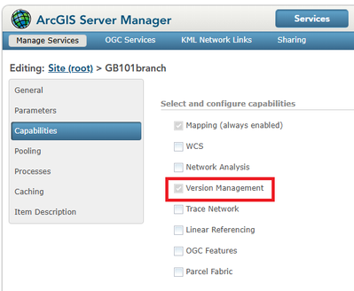

Hello @MichaelJenkins , you can see when a Service is Branch Versioned in ArcGIS Server Manager. You need to open the Capabilities section and look for "Version Management" being enabled.
